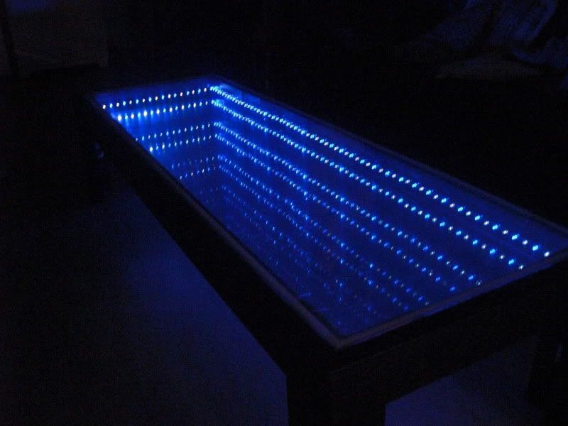

hi,
Is there a way i can use the arduino to sync music with LEDS?
Like useing an aux cord.
Then i want to move on to hooking it up to this LED table me and my friend made, then try it with the speakers on my car.
Any help would be appreciated, thank you

i wanted to know the proper way to build a circuit for it.
I found a diagram from audioguru he made this
http://www.electro-tech-online.com/attachments/electronic-projects-design-ideas-reviews/8266d1149690102-leds-sync-music-led-music-pulses-layout.png
would this circuit alone cover all the LEDs i want?

Postby Entropy » Mon Apr 26, 2010 11:07 am
rudster wrote:i wanted to know the proper way to build a circuit for it.
It depends on a lot of things. A circuit like that connected to one of the ADC pins of an Arduino would allow you to react to the music, but it depends on what you want to do.
Do you want brightness to just be proportional to volume? Then the circuit above would be sufficient on its own (possibly with some buffering for lots of LEDs).
Do you want something else to react to volume? (like lights chasing for each beat maybe) - The circuit above could be wired to an ADC input, and you could have code that did "something" with that ADC input
Fancy tricks 1 - With a bunch of bandpass filters, you could have frequency-dependent interactions
Fancy tricks 2 - If you just have certain music you'd like to sync to, you can prepropgram a light sequence that matches the music. This is how the people that do computer-controlled Christmas light displays usually do things.
Fancy tricks 3 - Have software on a PC that produces DMX-512 output in reaction to music, and build a bunch of DMX-512 lighting devices. (This is my current project for the year, with the final goal being computer-controlled Christmas lights.)

Postby rudster » Sun May 02, 2010 10:47 pm
Entropy,
im doing what you first said, i just want the LEDS to go with mainly the bass of the music and brightness pr-optional to the volume.
I might not even need the arduino,i just thought it would be easier. I'm pretty new to all this by the way.
I was thinking how would i power 172 LEDS with an aux. It took me 36v to power it useing (4) 9V batteries.
I also need to find a way to use an outlet to power it up. im guessing for that all i need is a fuse?
any advice would help appreciate it guys

Postby Entropy » Mon May 03, 2010 8:29 am
36V is a bit of an odd voltage to find these days.
If you rewire your LED strings such that they'll run off of 24VDC, Circuit Specialists has a nice cheap 24v power supply - http://www.circuitspecialists.com/prod.itml/icOid/9590

Postby rudster » Mon May 03, 2010 5:20 pm
Is there more a direct way, like how Christmas lights just plug in without a power supply
rudster
Posts: 9
Joined: Wed Sep 10, 2008 5:25 pm
Re: Sync music with Leds
Postby Entropy » Tue May 04, 2010 9:23 am
rudster wrote:Is there more a direct way, like how Christmas lights just plug in without a power supply
LED Christmas lights have enough LEDs in series per strand (usually 25-35) that the forward voltage is high enough to just use a dropping resistor and a basic rectifier without the dropping resistor have too much power.
That is to say, the way they're designed, the power supply requirements are so simple that the power supply can be fit into the plug at the end of the strand.
Dimming AC strands presents its own challenges - it can't be done using the hardware PWM in a microcontroller, it has to be done using software PWM that is synchronized to the AC zero crossings. In general, you have to be VERY careful when messing with AC directly. That $20 24v power supply allows you to work with LED strands in a MUCH safer fashion.

Postby rudster » Tue May 04, 2010 3:40 pm
hmmm, i have a spare computer power supply, would that work fine? just add up the voltage?
rudster
Posts: 9
Postby Entropy » Wed May 05, 2010 9:53 am
rudster wrote:hmmm, i have a spare computer power supply, would that work fine? just add up the voltage?
Well it might work if you rewired your strands for 12v, but at that point you'd have to control a decent amount of current. Also a lot of PC power supplies don't like uneven rail loading. (e.g. running lots off of 12v but nothing on other lines.)
That 24v power supply from CSI is really cheap. If you live in a country other than the USA you can probably find a similar deal elsewhere.
