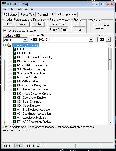

- Posts: 4
- Joined: Fri Jun 04, 2010 9:15 am
Re: Reset Xbee?
Hello,
I have the same problem with my two Xbee.
The caracteristics of them are :
- Xbee XB24-AUI
- 802-15-4
- 001-rev B
I use one adafruit adapter ( http://www.adafruit.com/index.php?main_ ... 70568895bb) with an FTDI 3V3 cable ( http://www.adafruit.com/index.php?main_ ... 70568895bb) and the last X-CTU soft.
At the begining, the two Xbee worked well without any bug. I have upgraded them with firmware 10E6 with no problem after this upgrade.
Later, I rewind to them and try to read the firmware and : nothing
The two doesn't answer to any line command or read and write.
The baud rate is 9800-8-N-1.
I try "Tobrew" setting with no success.
I also try with a Reset wiring Reset pin to Ground. ( http://forums.digi.com/support/forum/pr ... 3_offset,0)
Nothing !!!!!!!
Here is two screen shoots of X-CTU software.
1. PC Setting
2. Modem Configuration
Do you have an idea ?
Thanks a lot,
Michel (From France)

- Posts: 12151
- Joined: Thu Apr 06, 2006 4:21 pm
Re: Reset Xbee?
it says "Detected Baud Rate Difference"
did you change to different baud rates?
- Posts: 4
Re: Reset Xbee?
Yes,
I try all baud rate from 1200 to 230400.
Perhaps FTDI cable is out ?
I try a serial sniffer all seems good.
- Posts: 4
Re: Reset Xbee?
An other screen shoot with 38400-N-1
I cannot understand why he lost modem communication !
I will try without adafruit shield. As FTDI cable logic level is 3.3 V, I will shunt the SN74AHC.
- Posts: 4
Re: Reset Xbee?
Ok, I try an other FTDI cable.
It's running well.
My two Xbee are OK !
So, I will change my FTDI 3.3V TTL cable.
It's running well.
