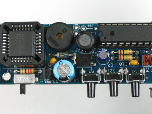

Check orientation of:
    * Electrolytic capacitors – The long lead goes in the ‘+’ hole. The stripe should line up with the ‘-‘ hole.
    * Transistors – These should line up with the outline on the silkscreen. Q2 has a bridge between two of the pins. Check the photos for the proper alignment of this part.
    * Other ICs Check the photos for proper alignment. Pay special attention to the orientation of any identifying notches and/or dots on these parts.

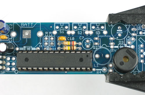

    * Verify component placement and soldering for C10, R1, R2
Verify processor orientation
    * The notch should line up with the silkscreen
Make sure the beeper is installed

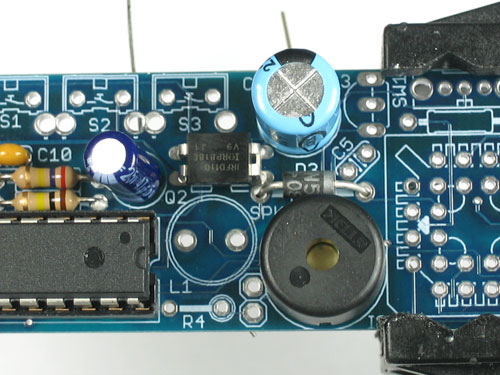

Low Boost Voltage. With no tube or VFD chip installed, you should measure between 40 and 70v on the striped end of D3. With a VFD chip installed, you should measure approximately 14-16v.
Check the supply voltage
    * You should have close to 9v on pin 1 of IC3 (the pin closest to the edge of the board)
Make sure there is a beep on power up (See above). The boost circuit will not work unless the processor is running.
Check the component placement & soldering for the boost circuit:
    * L1
    * Q2
    * D3
    * C5, C6, C7
Note the orientation of the bridged pins on Q2:
