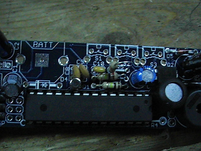

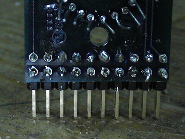

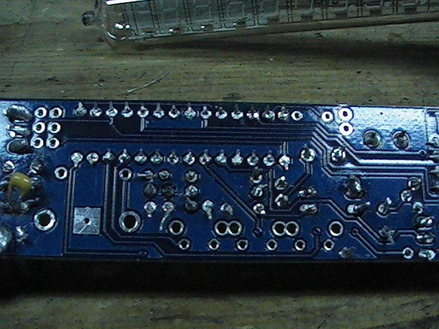

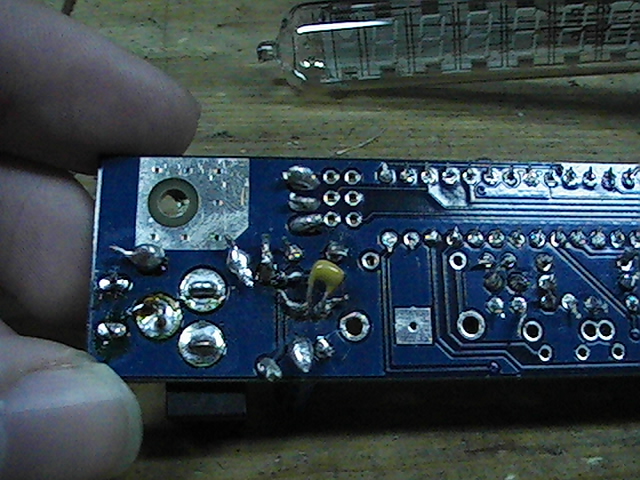

Postby Mundoo » Sun Feb 26, 2012 11:53 am

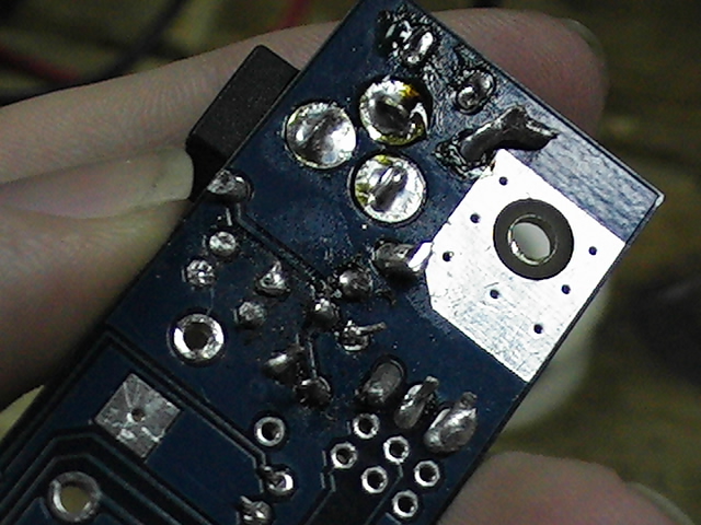

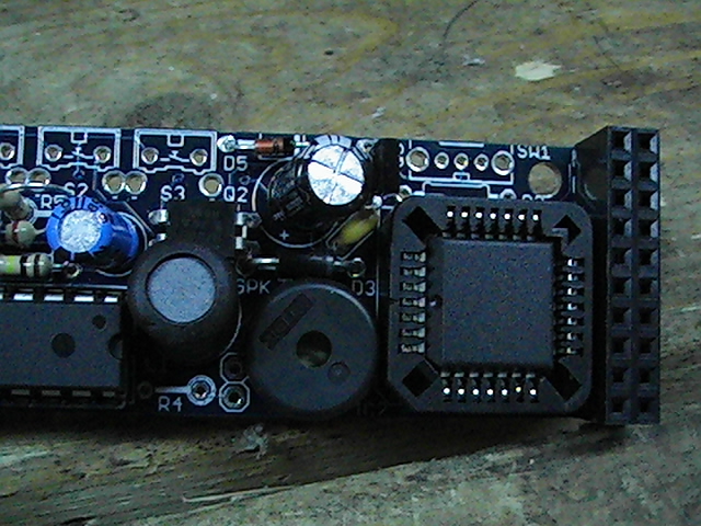

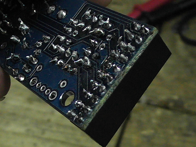

The PCB from left to right:
The back, left to right:

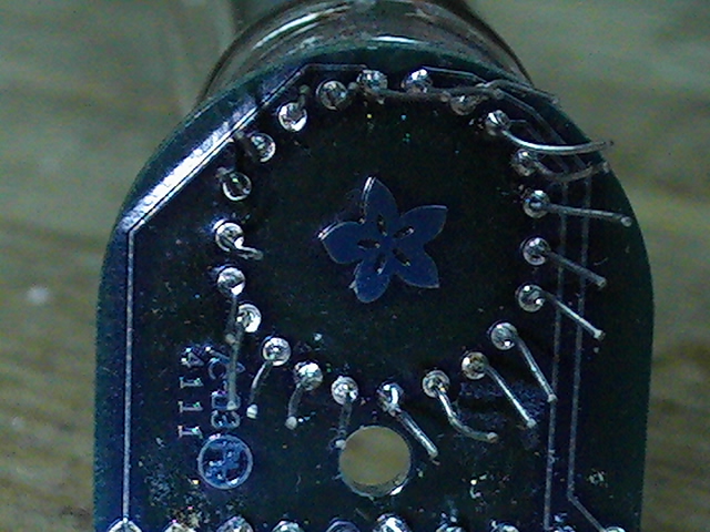

Closeup of VFD display header (female)
Closeup of CPU solder points:
You'll notice C1 is missing on the front, it's on the back because I made a booboo and couldn't quite figure out how to fix it, so I stuck it on the bottom.
I'll need to fix that so the thing fits in the case.
Closeup's of the VFD header (male) and the solder points for the display itself. These are a lot cleaner than the ones on the board, because of that new iron.
Sorry if the quality isn't too great, I couldn't find my good camera so I had to use the one on my video camera :/

Postby adafruit_support_bill » Sun Feb 26, 2012 12:56 pm
There are a few suspicious looking joints there:
A lot of the joints on the headers for the tube-board look look solder starved. That could explain the dark tube.
There are also a lot of long leads that could cause a short. These should be clipped close to the board.
The joints for the capacitor on the back look 'cold'. These (and any other joints that are not smooth and shiny) should be re-touched with a clean, hot iron.

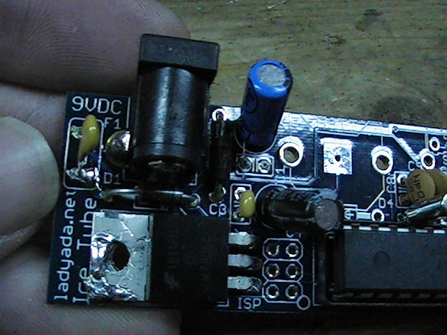

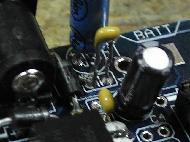

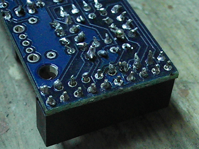

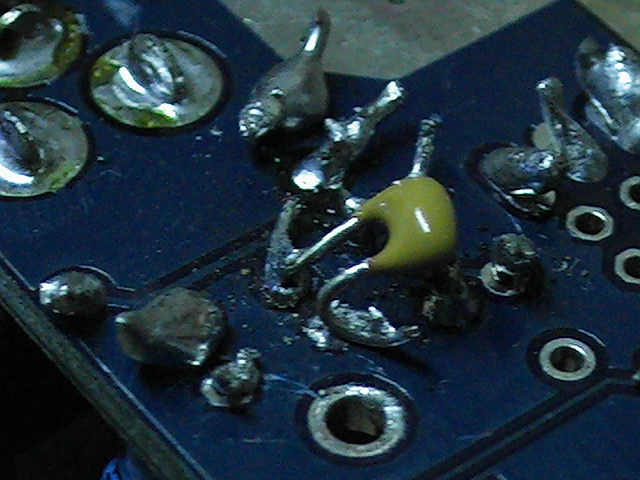

Postby Mundoo » Sun Feb 26, 2012 2:47 pm

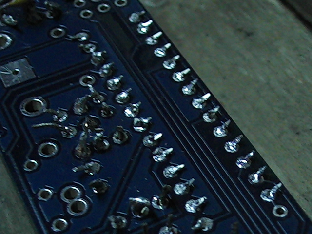

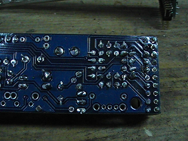

Hmm, after reflowing some points (and moving that capacitor I had mounted on the bottom of the board to the proper place on top), the display still won't light up.
I understand it's very dim when the clock first starts and you're supposed to set the brightness manually... but it's not dim, it's just... not even on. Turned the room lights off and I didn't see anything.

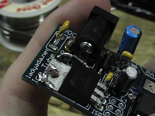

But I did notice something, when holding the PCB to unplug the power from the jack, the PCB felt quite hot. Around the LM7805C chip. Could it be the fuse heating up?
The new converter I'm using is as close as I can get to 9 volts @ 1000mA, it's 12v at 1250mA. The 9v converters I have laying around are AC or don't have enough power to operate the clock.
I tried cutting the connector off the 12v and putting it on the 10v, but it wouldn't beep when I did that (verified polarity too), so, dunno.
Pictures:
It might be blurry, but this was the best I could get of the C1 capacitor I moved.
This area of the PCB gets very hot after being plugged in. Could it be because the converter is sending it too much current?
Reflowed these points, they look somewhat like the diagram you linked.
However, the display still remains inactive. Not even dim, it's like it's not plugged in or anything. Perhaps the fuse is shutting off before I'm able to see anything on the display?

Postby adafruit_support_bill » Sun Feb 26, 2012 3:05 pm
Those solder joints on the header connections are looking much better.
A 12v supply is going to make the 7805 work a bit harder and get warmer than usual. Warm is OK, but it should not be painfully hot. Is the fuse getting warm too?
Does it beep with the 12v supply? Do the other voltages check out OK?
