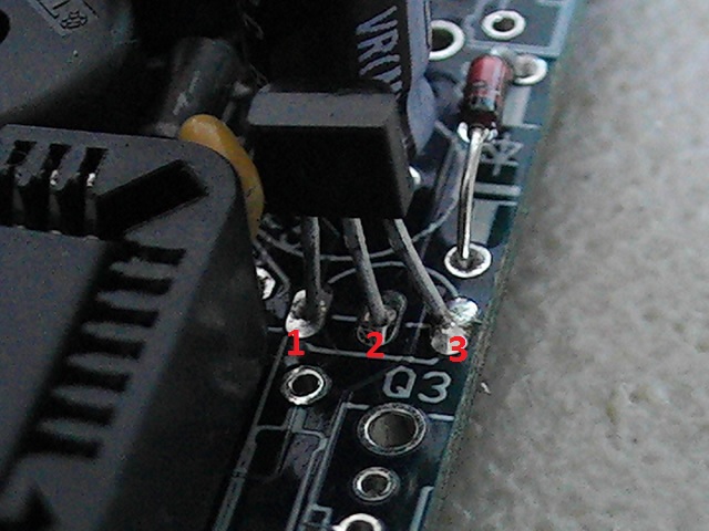

What voltages do you measure on each of the three pins of Q3?

Across 1 and 3, it measures 1.0 volts. Across 1 and 2, I get 1.6 volts. Across 2 and 3, I get nothing.

Postby adafruit_support_bill » Mon Feb 27, 2012 12:02 pm

Postby Mundoo » Mon Feb 27, 2012 12:13 pm
Okay, measured using ground = the flat bit of the 7805:
Pin 1: 4.7v
Pin 2: 3.0v
Pin 3: 3.0v

Postby adafruit_support_bill » Mon Feb 27, 2012 12:23 pm
Now measure the voltage on pin 13 of the Atmega chip.
And, just to double check, the voltage on pin 5. (should be the same as pin 2 of Q3)

Postby Mundoo » Mon Feb 27, 2012 12:45 pm
Pin 13: 1.14v
Pin 5: 2.94v

Postby adafruit » Mon Feb 27, 2012 1:24 pm
why isnt the 22 ohm resistor installed?

Postby Mundoo » Mon Feb 27, 2012 1:35 pm
... you know I have no idea, I'll go install it.
Be right back :3
Edit: Okay, it's installed now. I'll get those voltages again in a minute.

Postby adafruit_support_bill » Mon Feb 27, 2012 2:12 pm
On Q3, carefully short pin-1 to pin-3 and see if the tube lights.

Postby Mundoo » Mon Feb 27, 2012 2:20 pm
Okay, I shorted pins 1 and 3 on Q3. Still nothing. It beeped, but no display.
I tried it 3 times, but now it's not beeping and there's two dim orange lines running horizontally across the display on the inside. It does it even if I'm not shorting Q3 :/

Postby adafruit_support_bill » Mon Feb 27, 2012 2:56 pm
Q3 controls the filament voltage in the tube as well as power to the VFD chip. The missing 22 ohm resistor was preventing the filament voltage from getting to the tube, but it seems we have other problems as well.
What voltage to you see on the 3 pins of Q3 now?
