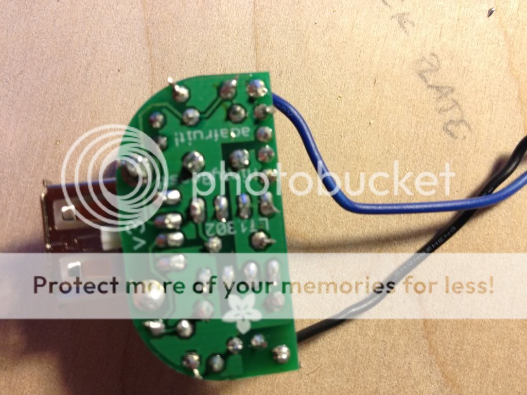

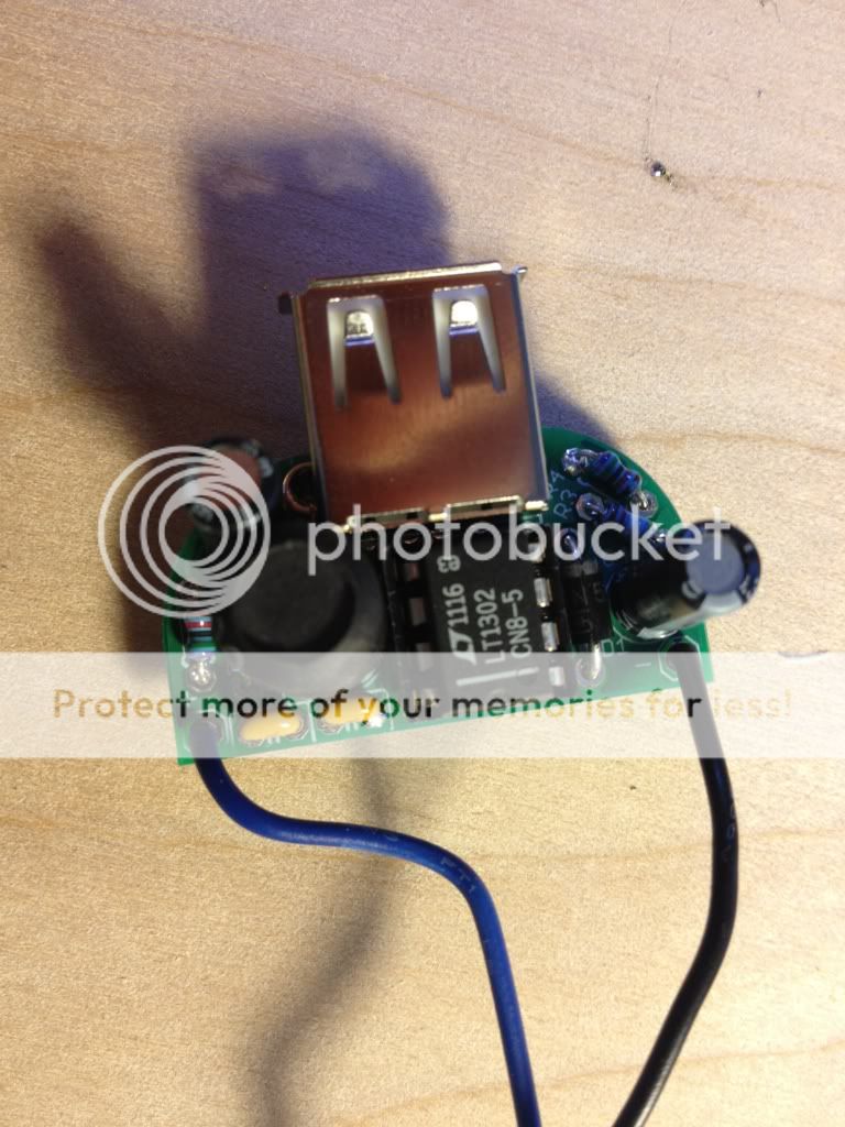

Okay so, first few times soldering up a board so don't hate too much.
Here are the front and back.
http://i881.photobucket.com/albums/ac14 ... c69881.jpg
http://i881.photobucket.com/albums/ac14 ... 7b9f6b.jpg
Testing the voltages:
1st and 4th pin: 4.9V
2nd and 4th pin: 0V
3rd and 4th pin: 1.9V
Obviously my problem is somewhere with the 2nd pin, however I'm not sure what this is.
Any help would be greatly appreciated ! :D

Postby adafruit_support_bill » Thu Mar 01, 2012 4:06 pm
Can you get a sharper shot of the bottom of the board? Your problem is likely somewhere in the soldering of R1 & R2.

Postby shabada » Thu Mar 01, 2012 4:15 pm
adafruit_support wrote:Can you get a sharper shot of the bottom of the board? Your problem is likely somewhere in the soldering of R1 & R2.
This should be more clear.

Postby adafruit_support_bill » Thu Mar 01, 2012 4:32 pm
I think the one circled in red is the problem. The ones in yellow look suspicious as well.

Postby shabada » Thu Mar 01, 2012 4:54 pm
Thank you very much. Works great now. I believe that it was indeed the red circled lead.

Postby aylwardc » Thu Mar 22, 2012 2:14 pm
Hmm, I seem to be having a similar problem. Does anyone have any ideas for me?
1st and 4th pin: 2.95V
2nd and 4th pin: 1.8V

Postby adafruit_support_bill » Thu Mar 22, 2012 2:53 pm
Looks like a few cold solder joints there. Retouch any that are not smooth & shiny. And make sure that the solder has flowed well onto both the pin and the surrounding pad. You should cut those leads closer to the board too, so they don't short out on anything.
The ideal joint should look something like this:
