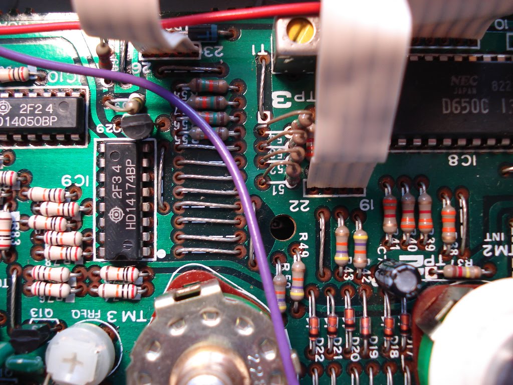

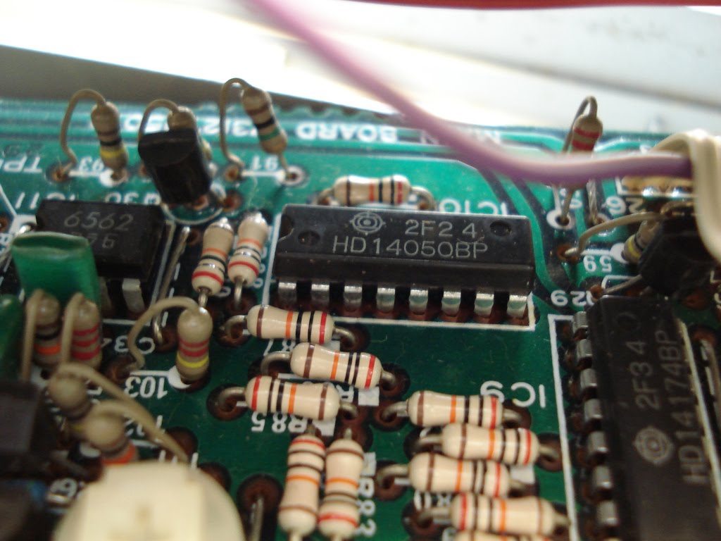

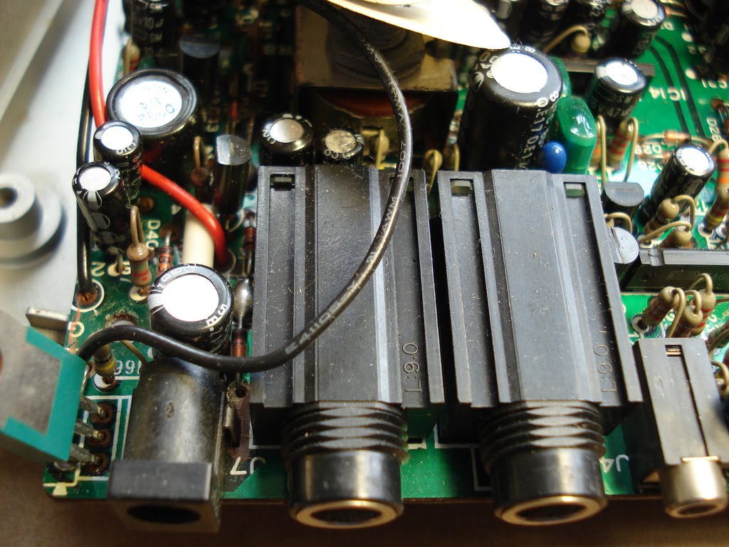

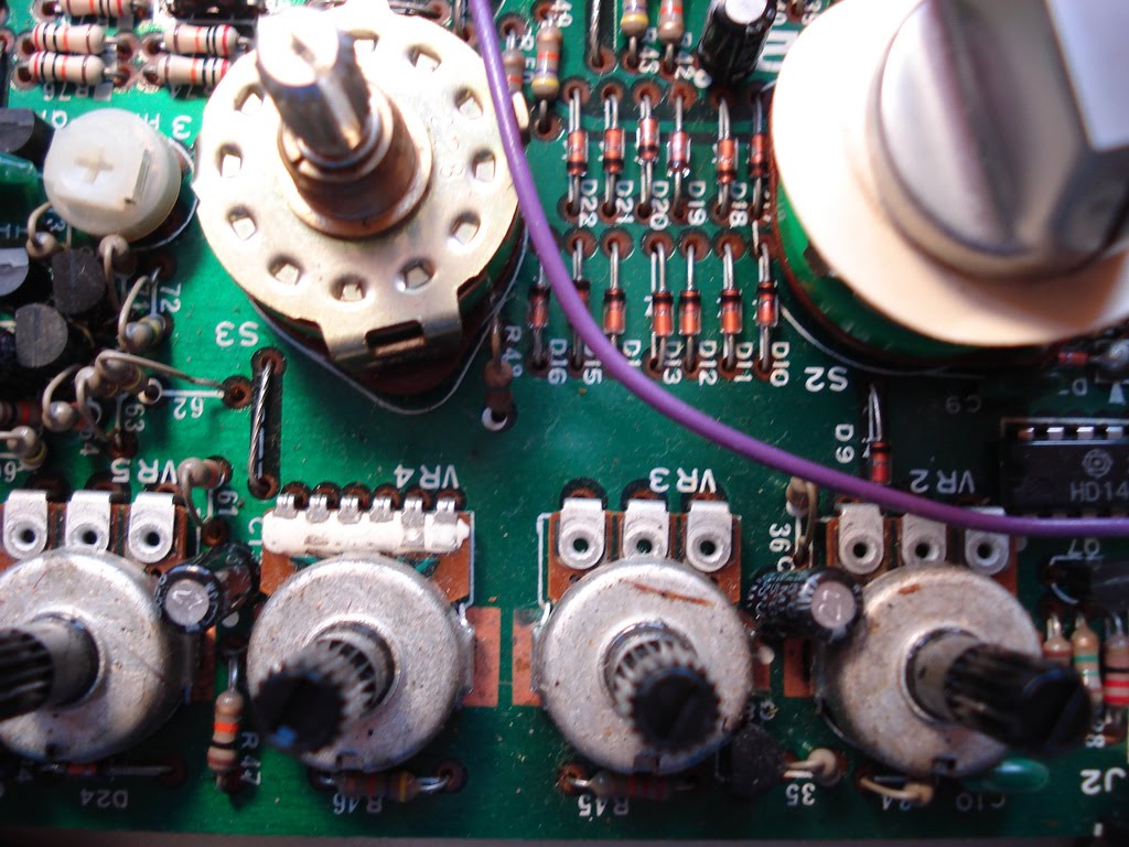

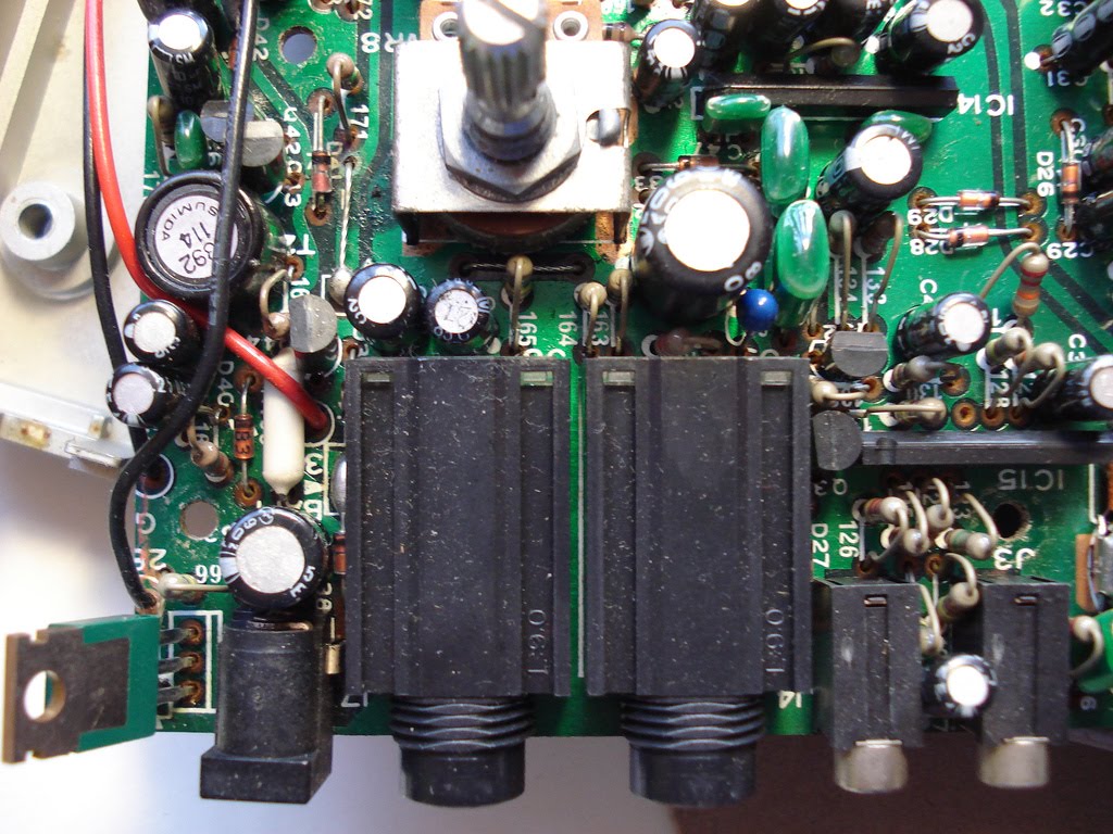

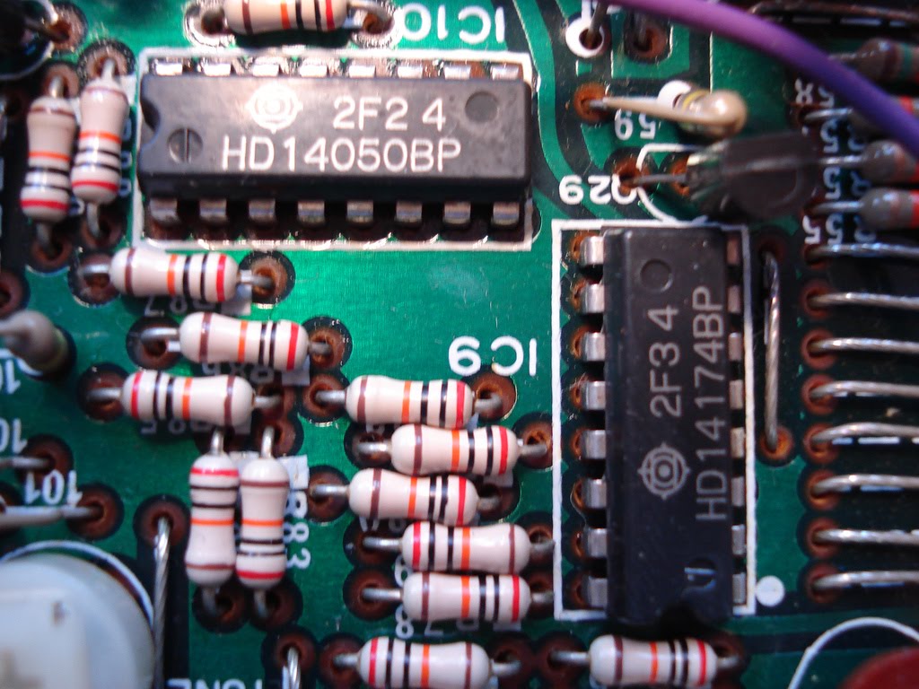

I while ago someone was asking about the position of the thermistors in TB-303 in relation to the accuracy of their x0x build. I stumbled across these images on the Matrixsynth Blog and thought they would be useful reference for x0x bulders and TB cloners.
Images found via: http://matrixsynth.blogspot.com/2010/07/inside-roland-tb-303.html
