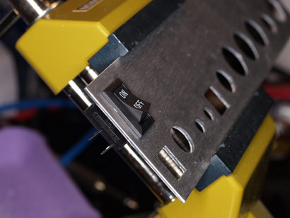

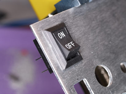

today i grabbed my proxxon to drill the space for an extra on/off switch:
Image . Image
Image . Image
Image . Image
wonderfull box, the x0x, i will do some tests between our ML-303 v6 clone and this machine soon

I bought one from Digikey.
Just finished installing. My fingers are sooo sore. I drilled a couple holes and proceeded to cut the opening till it matched the rectangular press-fit switch using just an exacto knife (and 6 blades).
Turned out great, looks great. :)
Wished the whole time that I had a small metal file. I'm an electronics tech, not a mahinest. have all the tech tools but lack a simple file :oops:

Postby Fallenstar » Sat Nov 19, 2005 7:38 pm
What you need is a case modder's tool, A hand nibbler. These can be found in many computer stores. Just drill a hole and you can cut the metal nicely. I have a switch all set to go once I get it working right.

Postby adafruit » Sat Nov 19, 2005 9:41 pm
http://www.ladyada.net/resources/equipt.html has a picture and link to a nibbler

Postby maxtim » Sun Nov 20, 2005 4:01 pm
A nibbler *smacks forhead* of course........ :oops:
I remember now. I've used that at work.
Thanks so much.
Next time I need to do another mod that requires a straight edged hole I will remember.
For others doing this mod, they can save themselves alot of hard work by having the correct tool.
Most of the mods I will/have done are just drill holes and I fortunately do own a simple hand drill :)

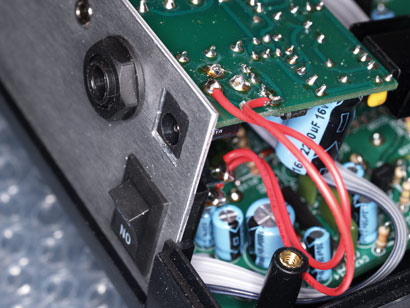

Postby cheesy » Thu Feb 16, 2006 8:46 pm

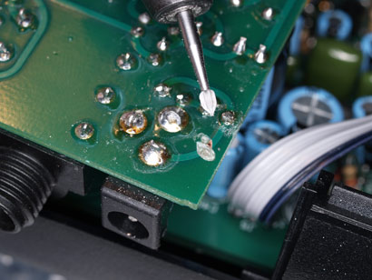

How did you wire it up? I don't have my kit yet, so maybe it will be obvious when I get it, but isn't the power connector soldered directly to the board? From the pictures it looks like you may have cut a trace or drilled out one of the holes to bypass it. Details would be appreciated.
I'd like to add a switch as well as a battery pack. Ideally I'd have a 3-way switch (or two 2-way switches would work I suppose) so I can turn it off, on via the batteries, and on via the power adapter.

Postby Chairman Meow » Thu Feb 16, 2006 8:55 pm
cheesy wrote:How did you wire it up. I don't have my kit yet, so maybe it will be obvious when I get it, but isn't the power connector soldered directly to the board? From the pictures it looks like you may have drilled out one of the holes to bypass it or something.
I cut a trace with a Dremel and jumped the open across the switch. Click photos for larger version.
[url=http://gl1tch.com/gallery/x0xb0x/x0xb0x_onoffmod1]
Image[/url]

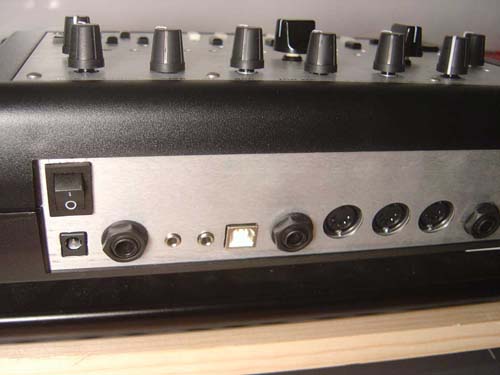

ok, I also did the on/off mod, here's pictures

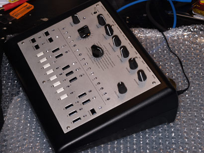

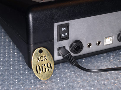

Here is another on/off power switch mod, and some more pictures for you powerswitch freaks:
Finished!
Build Steps:
I got the switch from futurlec, in case you're interested.

Postby mome rath » Sat Jul 08, 2006 3:23 am
hawt! I still need to do this to my x0xes
btw that's some big ugly wire you're using there.
