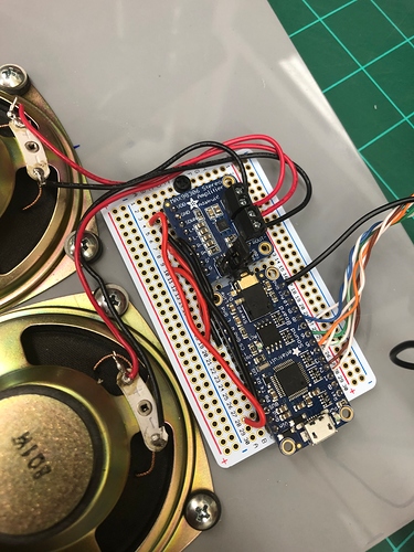

by Wood4sheep2q on Sun Mar 03, 2019 11:18 pm
I bought this sound board and have it functioning just fine except the sound is really soft. I was hoping for a little more presence. I first bought 2 of your 3watt 8ohm and then 2 1 watt 8ohm. The sound is really not that loud. I tried using the volume pins but quickly found that default was at the highest volume anyway.
I am not that electrical knowledgeable. Is it the ohm. Do I need to buy those 4ohm pair you have?
Or do I have to go the non-amped board and get one of your amps and power that? Thanks for any help.
I built this table and have a set of rocker switches that run to the soundboard trigger pins.
I laser cut a speaker grill and have just enough room to put them in above the grill with the board etc.
just want to hear clearly at the desk.
Or maybe I have to run a wire to an external powered speaker to get what I need.

Re: DAFRUIT AUDIO FX SOUND BOARD + 2X2W AMP sound is faint
by adafruit_support_carter on Mon Mar 04, 2019 11:32 pm
If the sound at max volume isn't loud enough, then getting a more powerful amplifier would be the better option over trying to use 4 ohm speakers.
You say you just want to hear clearly at the desk. I would think / hope the amp would be enough for that. But maybe the grill + the underside location is making the sound far enough away that it's too quiet for you? Not sure. But if you really want louder, then you want a more powerful amp. If you do that, be sure to switch to using the line level outputs and *not* the amplified outputs that go to the speakers. That is - don't connect the output of the 2W amp to the input of another amp.
by Wood4sheep2q on Wed Mar 06, 2019 8:35 am
Thanks for the reply. It is soft sounding even when sitting on my workbench. Sigh! So... which amplifier of yours would you recommend for this?
by adafruit_support_carter on Wed Mar 06, 2019 12:10 pm
You can check out the options here:
https://www.adafruit.com/category/526
Which one to recommend is a little tough though. It's hard to estimate how much power you need to get to the loudness you want. The Audio FX board is 2W, so anecdotally, you know you need more than that.
But is 3W enough:
https://www.adafruit.com/product/3006 (mono)
Or 3.7W:
https://www.adafruit.com/product/987
20W should be more than enough, but might even be overkill:
https://www.adafruit.com/product/1752
by Wood4sheep2q on Mon Apr 15, 2019 3:35 pm
so....the 3.7 watt amplifier worked great. Sound is just how I wanted it now:

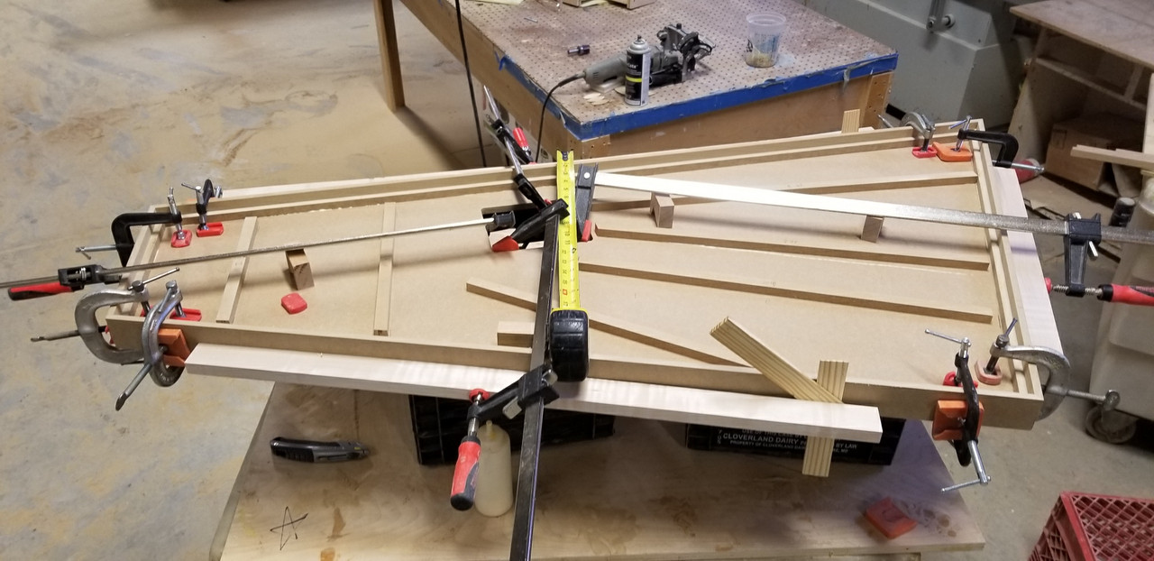

Lots of time into designing the desk and then the work to install switches and make great sound. The desk is done in collaboration with a local cabinet maker at his shop and Yes I am selling these desks. It would be hard to pass on the info the desk itself as it is high end furniture quality. We work together in a fairly large and well equipped workshop to produce the desk. The desk itself is made in three parts so it can ship and the main body is built in what is called a torsion box which has hollow passages that allow for wiring to pass through the desk. It also allowed me to use the air space within the desk as a form of speaker box to augment the sound quality. Here is the desk under construction; Image You can see the passage areas. This also makes the desk stable and it will not warp.
The top is formica and the bus for the switches was cut in before applying the formica top. The area for the speaker grill was cut in ahead of finishing and painting.

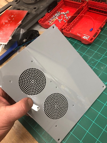

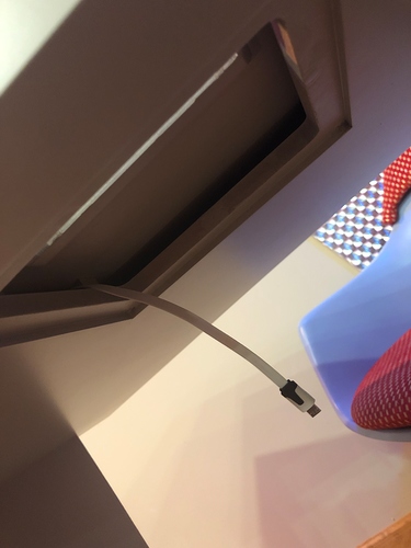

Here you can see the speaker grill opening and the usb power cord dangling through ready to hook up to the sound system.
I spent a lot of time on sound development and the grill itself went through a number of iterations until I stumbled upon this design that separated the air moved by the speaker from the body of the desk in order to facilitate the desk as speaker box. I used a glowforge to cut the grills.

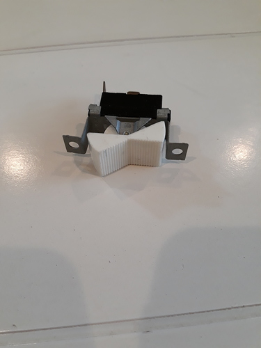

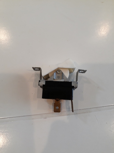

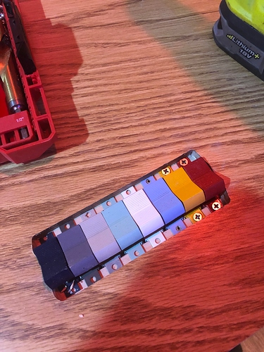

Vintage rockers are hard to come by and even harder to identify the right ones. Proper rockers do have the hardware tucked under the switch so they can be put next to each other.
Here are two photos of proper rockers with the right ridges, sizing and mounting hardware.
I altered the mounting on these to fit the bus for the desk.
Finding 60 year old switches is difficult. I have a line on a few sources and you should drop me a line at amplector@gmail.com if you are wanting some I can help.
The painting colors are very very carefully matched with Museum quality references thanks to info from some friends of mine that have access to original switches and then weeks of tedious work on my part to find spray paints that closely matched original colors. I am glad to pass that info on if needed as well by email.

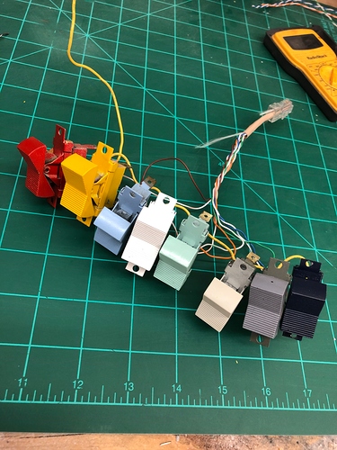

Here are 8 vintage rockers primed and painted to spec. and then set up to wire to the soundboard. I used a cat 6 connector and wire as it had just the 8 wires needed for the 8 triggers I am using and then a separate connector for ground.

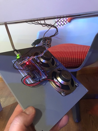

8 vintage rockers being installed
Here is the soundboard and grill powered up and connected to the rockers being tested before screwing the grill in.

here are the jumper spot and after removing soldier to post in case someone else has that issue and misses the blurb about it in the tech data provided on the web page.
There is one other type jumper that you scratch out the connection
