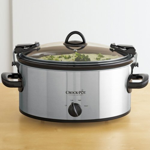

hi all
quick question
the sous-vid display when in run mode.
the # on the display with the % sign,what does this # represent?
thanx in advance...
fuceye

Re: sous-vide desplay
by adafruit_support_bill on Fri Aug 02, 2013 6:28 am
That is the duty cycle of the time proportional output from the PID. When warming up, it will be at or near 100%. As it reaches the setpoint, the output will be reduced to just enough power to maintain a steady temperature (typically around 5% on the rice-cooker used for the prototype).
by fuceye on Fri Aug 02, 2013 10:38 pm
is there and easer way to tune? i've read all the material but its mostly just cloudy with a chance of meatballs... :D i kinda get the premis but fear it will be mostly hit and miss,at the rate of hit and miss i should have it tuned in the year 2027... :D
by franklin97355 on Sat Aug 03, 2013 1:25 am
mostly hit and miss
Yes, there is a lot of magic involved in tuning PID. There are so many variables that the formulas are not absolute, you can come close but unless you can quantify all the parameters it's still a trial and error proposition.
by adafruit_support_bill on Sat Aug 03, 2013 6:03 am
You can start with the auto-tune. Than should get you in the ballpark.
Then start tuning the proportional term. Try to get it so that it comes up to temperature reasonably quick without continuing to oscillate.
At this point, it will probably settle in to a temp slightly below setpoint. You can start gently bumping up the Integral term to correct that offset.
For most cookers, you don't need to mess with the derivative term much.
by fuceye on Sat Aug 03, 2013 5:35 pm
well sir i do thank you very much...
went back and looked at the tempter before heating i think t was 33c.i then set the sp to33.5 and hit the auto tune...that got me in the ball park.then i rased the sp to 59c and let it do its thing...i tinkered with it as you suggested above^^^ and got it to remain steady at 59.6-59.13
i threw a tenderloine in for 1.5 hours and then scorched it on the hot bbq for 30 seconds per side....dude i be sous vidden now...and i saved a load of scrilla
by doing it this way instead of buying one off the shelf.....
this was a great project that i know i will use often....ok got to go do some more steaks the lads or on there way with the beer....lol
fuceye
by fuceye on Sat Aug 03, 2013 5:38 pm
oh, by the way, my duty cycle turned out to be around 19.5% at a stable temp. its a large slow cooker...again than for the help...
sp=59c
kp=1603
ki=.30
by dbick on Fri Nov 22, 2013 6:44 pm
is that kp 1603 or 16.03? I have a similar cooker and after autotune it set the kp to 12.05. It is still overshooting by around 5 degrees so I trying to figure out what to change.
Thanks
dbick
Posts: 3
Joined: Fri Nov 22, 2013 6:42 pm
by adafruit_support_bill on Fri Nov 22, 2013 7:36 pm
What is your Ki? Some overshoot on initial startup is typical if you have a non-zero Ki. I've been experimenting with a pre-heat phase to keep the integral term from causing overshoot at startup. The code is here if you want to try it:
