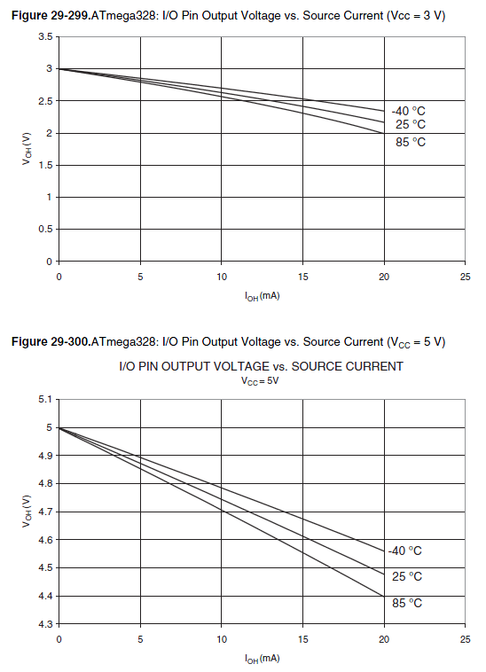

V-I characteristics of AVR micro outputs? Current limiting?
Re: V-I characteristics of AVR micro outputs? Current limiting?
terryking wrote:How about "The pin driver is strong enough to drive LED displays directly." THAT could be misinterpreted by someone pretty easily!
oPossum wrote:Get the ATmega 48/88/168/328 spec sheet directly from Atmel web site. .
Let's try to get some consensus on what Arduino users should to told about acceptable output pin currents. The 40ma the Arduino website talks about is a problem, and there's no mention of total current.
westfw wrote:I think the current recommendations are working fine, actually... "Use a resistor for LED and never connect anything that uses more than 40mA."
oPossum wrote:Do you have a link to the other spec sheet? I would like to take a look at it.
