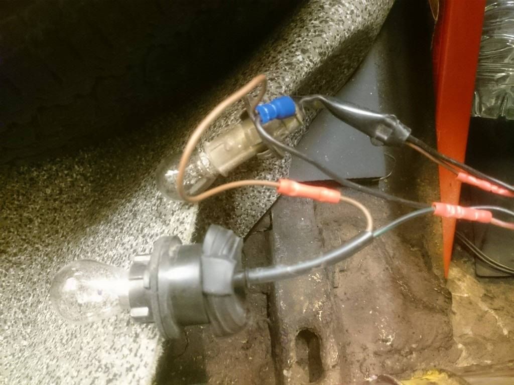

Here's the wiring for the 3 functions I'll be using. One of the bulbs houses dual filaments for running/brake lights.The other bulb is for the turn signal
Up until now, the signals (controlled by 3 pins on the Arduino) have been controlled by simple buttons which used the common power/ground from the power supply so this is new territory for me.
Obviously I need to test all these with a multimeter but I'm not sure exactly how to use these wires. For example, do all three need seperate grounds or can they be shared? When it comes to a common ground, in order for the LEDs to have a reference, does this only concern the power supply & LED strips or do I somehow need to make the ground shared across all components of my LED matrix? For example, would there be one large ground to the LED matrix and then all that's needed is to send the positive wires into the Arduino (using the discussed voltage divider of course).
I hope it seems that I'm understanding this to some extent but thanks again for all your help,
Kyle

by adafruit_support_bill on Fri Feb 17, 2017 11:03 am
So you will need to build 3 resistor dividers as discussed above.
Connect all the grounds to the chassis or wiring harness ground.
Connect the positive legs of the dividers to the positive wires going to the bulbs.
Then test: Measure the center tap of the voltage divider when the bulb voltage goes HIGH and verify that it is in the range of the Arduino logic HIGH (3.3v-5v.)
Once you verify that the dividers are working as expected, you can connect them to the Arduino:
Connect the Arduino GND to the common ground for the dividers.
Connect the center taps of the dividers to the analog pins on the Arduino.
Posts: 76651

Automotive electrical system can be very noisy and poorly regulated. I would use opto-isolators on all the inputs and outputs to electrically isolate the arduino. Also, use a single point ground connection to avoid ground loops
