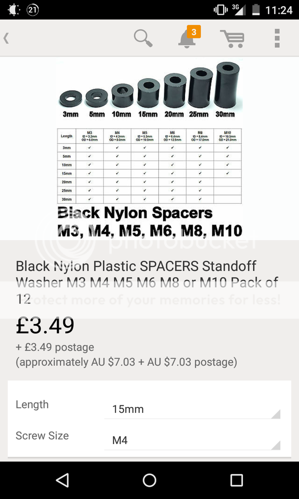

Note that I used 15mm spacers to make room (just!) for the bluetooth modules etc.
http://www.ebay.com.au/itm/301400291143?_trksid=p2057872.m2749.l2649&var=600371081173&ssPageName=STRK%3AMEBIDX%3AIT
I grabbed the 15mm M4 but I drilled them out to M5 - had to go the smaller size to get the larger charger to fit on my formula rim.
