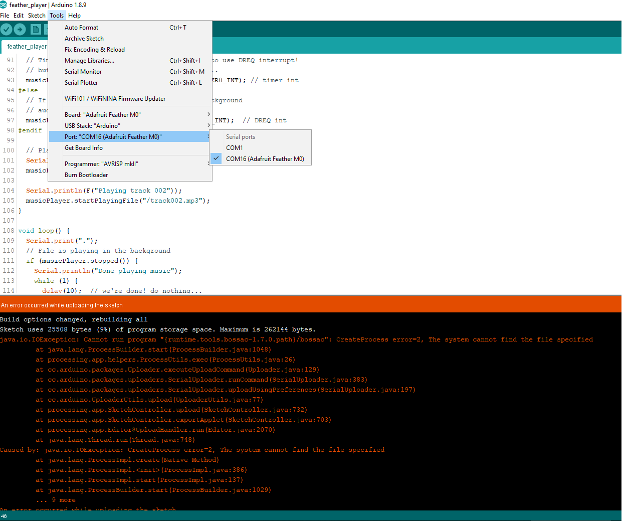

I truly need your assistance! I have a project that was working great for the last three years, today I had to make some updates and during the work I've updated the boards and libs, from that moment on my project couldn't be compiled so I tried to use blink and even that doesn't work (compiled but couldn't uploaded to the board), currently the red led is flashing (no cause of the blink that couldn't be compiled, watch here) I've updated the Adafruit SAMD Boards ver 1.5.0 and WICHED ver 0.66, I've also updated lib to 1.0.8 and all stooped working, when clicking the get board info I do get:
BN: Adafruit Feather M0
VID: 0x239A
PID: 0x000B
SN: Upload any sketch to obtain it
but that's about all.
current programmer: "AVRISP mkll"
if I try to run the example of "feather_player" that i was using for a long time, now after successful compilation i get the following error:
Sketch uses 25508 bytes (9%) of program storage space. Maximum is 262144 bytes.
java.io.IOException: Cannot run program "{runtime.tools.bossac-1.7.0.path}/bossac": CreateProcess error=2, The system cannot find the file specified

OK! managed to fix it all and get it to work.
deleted folder Arduino15 from C:\Users\Admin\AppData\Local
reinstall all broads per instructions here
consider this ticket close.

I also had this problem, and I tried deleting the Arduino15 folder and reinstalling the boards, but it didn't help. After much searching, and some digging on my machine, I discovered that the "bossac-1.7.0" folder had been changed to "bossac-1.7.0-arduino3" in the Arduino15/packages/arduino/hardware/samd/1.8.1 folder. I fixed the issue by going into the Arduino15/packages/adafruit/hardware/samd/1.5.0/platform.txt file and changing the line that says:
Code: Select all | TOGGLE FULL SIZE
tools.bossac.path={runtime.tools.bossac-1.7.0.path}
to
tools.bossac.path={runtime.tools.bossac-1.7.0-arduino3.path}
Sketches now compile and load to the Feather M0 without issue.

mhooten wrote:I also had this problem, and I tried deleting the Arduino15 folder and reinstalling the boards, but it didn't help. After much searching, and some digging on my machine, I discovered that the "bossac-1.7.0" folder had been changed to "bossac-1.7.0-arduino3" in the Arduino15/packages/arduino/hardware/samd/1.8.1 folder. I fixed the issue by going into the Arduino15/packages/adafruit/hardware/samd/1.5.0/platform.txt file and changing the line that says:
to
I had the same issues and this fix worked for me as well.
FWIW, I did a clean install of the IDE on a virtual machine that never had the IDE, I installed the Adafruit SAMD Board Manager as well as the Arduino SAMD Board Manager, and I still had the bossac issue. Everybody, save yourself some hassle, don't bother deleting all your Arduino15 files, just edit samd/1.5.0/platforms.txt as described above. That is, until the bug gets fixed in 1.5.1. :-)
