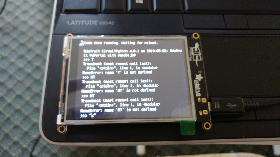

Hi, I am getting weird error messages, like
NameError: name 'T' is not defined, any ideas?
Regards, AB

Not sure, there is no variable named T in the program. Can you give more information?

Hi, unfortunately it isn't giving me any further info, like where this error is (or the file).
I have followed all the instructions that were given to try out the IO portal, but no joy. It does run the original code.py file with the quotes. I checked that all the correct files are there.
I did have trouble getting it started on my Ubuntu laptop, but it seems to work ok now if I switch back to the original code.py
Regards, AB

Did you run the command linked above to remove modemmanager?

Hi, yes, I ran this:
sudo apt purge modemmanager
Then I tried Picocom again (which we normally use to connect to Micropython running on an EsP32) but it still failed.
Then I ran into this article on the web, which describes exactly the same problem I am having:
https://bigl.es/pyportal-corrupt-files/
So I then restored my code.py to the original default 'quotes' code, and it ran fine. I was careful to hit the Eject button in Ubuntu Nautilus, to make sure it was finished writing the file (which I always do, having read the docs).
So, I restored the thermometer.py into the code.py file, thinking it may have been corrupted. This time I got new errors:
Then I rebooted it and it went back to the same errors as in the first picture. Sheesh.
Is the temperature sensor itself at fault?
Could this be a corrupted library component? Maybe I should start from scratch and reformat the whole thing??
Regards, Adrian

Have you set up a feed named temperature in your Adafruit IO account? The error message is saying it can not locate that feed.

Hi, no, I never got that far because I could not get the program to run, as per the instructions - I only got as far as setting up a new IO account. This was apparently unnecessary as I have already had an account for purchases for quite a few years.
But thanks for pointing that out as I was wondering if the Pyport might have a defective temperature sensor.
Regards, AB

I think you're OK. Go ahead and setup the AIO feed and keep working through the guide. If you run into other snags, report back here. But for now, the error message you're getting makes sense. Hopefully it's just a matter of a few things like this to get you working.

Hi, ok, thanks for letting me know. If it turns out to be that I hadn't set up Adafruit IO, then that will be a relief. But it would probably help other users to understand that the program won't run properly until this is done.
I was expecting to see this, with perhaps a subsequent message saying "no sensor found in IO account":
Regards, AB

Hi, ok, so I have created a block and a widget to read the temperature at AIO:
loggerman∕Dashboards∕Pyportal Sensor Test
I just used the default slider configured for zero to 100 re temperature reading.
But I still get the same errors that are seen in the original image I posted.
Shouldn't I have to tell the code which widget to send temperature data to?
I guess it's back to 'read the docs' time ...
LATER THE NEXT DAY ...
I did read the docs again, and I realized that the feed at AIO needs to be specifically named 'temperature'. I changed that, rebooted the Pyportal, and voila, I got the Analog Devices splash screen. Yay!
So it seems you were correct, I should have set up the AIO system properly, before I ran the code in the Pyportal. I still think it should boot with the splash screen and detect that the AIO setup was not done.
After the boot splash screen it then goes blank and won't light up with the temperature display when I wave my hand in front of it, so should it do that by default? It is sending the data to AIO, so at least I know it is working.
