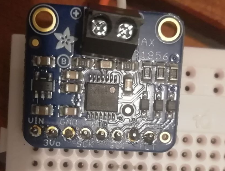

ok, the welds are not spread over the entire pellet. But I checked for continuity.

i'have re-soldering the header pin but i've got the same result ...

Re: MAX31856 on Raspberry pi 4 : Temperature = 0,0
by adafruit_support_carter on Thu May 07, 2020 11:13 am
Unfortunately I think it could still be soldering related. I can't tell for sure in the photo:
but it looks like some of the pins are still a little cold and under-soldered and not wetted out enough onto the pads.

by Monsieur_x on Thu May 07, 2020 11:55 am
Thank you very much I redid (well) the welds. I have the temperature displayed!
Thank you very much for your help! I don't know how to thank you
