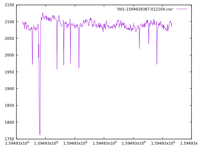

My project needs to be able to detect loud noises, so I've been using Adafruit's electret microphone hooked up to a Feather M0 WiFI sampling at 10kHz. It tries to detect anomalies by looking to deviations of a few tenths of a volt. The background variation when quiet is typically 8-10mV, but when I clap near the microphone, I get about +/- 1.5V. I actually do this using integer math to make it faster. The ADC is set to 12bits full scale (4095 max), and that should correspond to about 0.8mV per tick.
It's properly triggering on loud claps like so:
But it's also registering a lot of stuff when I don't perceive any significant or sudden sounds:
and I can't figure out what is causing that drop of several tenths of a volt for about 0.5-1 ms (the whole curve is about 50 ms). It happens a LOT (every second or two, including when there's nobody in the room). I'm trying to figure out if my circuit is electrically noisy, or if I'm picking up real sounds I'm not perceiving.
What I've noticed, these phantom triggers are always voltage dips, never spikes, and they're always accompanied by slight rise in the average voltage that tapers off afterward.

I had almost convinced myself that they were actual sounds (like the creaking of my chair or something), when I decided to move the mic to another room, and the frequency of the readings went way up despite being in a quiet room.
This is a perfect example:
If I were playing this back as an audio clip, I'm pretty sure I'd hear this as a pop in an otherwise quiet recording.

Wacko theory #625, it's the WiFi:
I got a series of dips that were strangely uniform.
The first one was an anomaly, but the rest occured almost exactly at the same place in the buffer.
Each dip occurred about 100 measurements into the packet. Now the way my code works is that if there's a big swing from the mean--either positive or negative, then the buffer gets flagged to be sent to the server, but the sending happens asynchronously. It also takes a while to construct the packet and send it.. about 10ms, or 100 readings. When the packet gets sent, I am guessing one of two things happen to cause the dip. Either:
    1) The power draw causes a ground bounce
    2) The wifi signal gets picked up by the short wire that connects the amp output to the analog pin
If it's #2, then that would explain why it's not consistent.... the wire changes orientation and that causes it to pick up the signal differently. It also reminds me of the other thing about working with analog circruits (especially RF), and that is keep your wires short or they'll pick up random stuff. I'll try making the wires much shorter and see if that helps.
If it's #1 I'm not sure what I can do, other than a filter cap maybe?

Your theory about Wifi sounds reasonable. That's an EMF source, and the protoboard's traces are right over the antenna.
Try using a couple runs of twisted pair for the connections between the Feather and the mic: one pair carrying 3V and GND, and the other connected to the mic's output and GND. For the mic pair, use a GND pin as close to the analog input as possible, and only make the GND connection on the Feather side. That will give the best cancellation of induced EMF as seen at the analog input.
