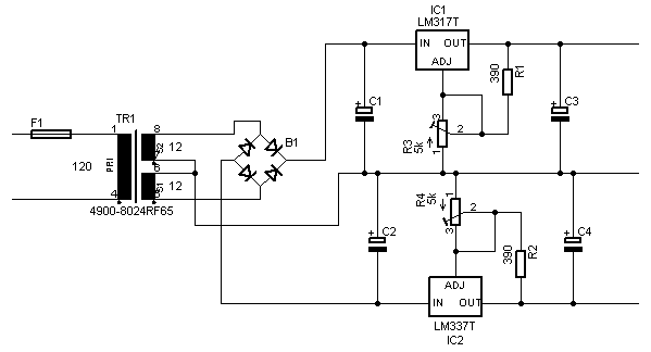

msymms wrote:Right wrong link. So, will the 8048RF65 suit my needs?
I knew I would need a good heat sink. I was considering adding a small fan as well.
-mark
No, you had the right link. The 8024RF65 is what you want. 12 VAC per secondary.

Is there any advantage to running each secondary to its own bridge, then connecting the positive output from one and the negative output of the other both to ground? Would this make each rail isolated?

Sure, two bridges will allow isolated rails. Each could be a positive or negative supply. The LM317T can be used for both. The disadvantage is one more diode drop in the rectification, so the max output is about 1 volt lower. Using a 14 volt transformer would compensate for that and allow a solid regulated 15 volts from each output.
