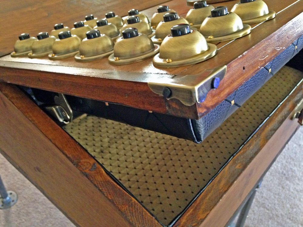

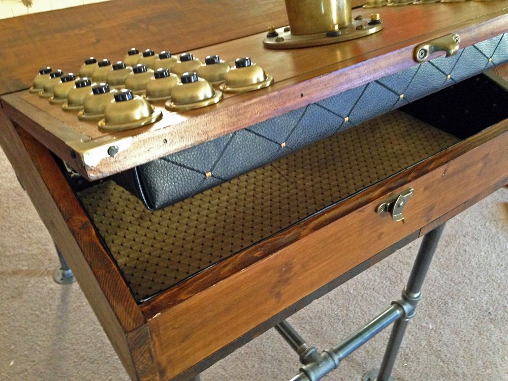

The brass doorbell buttons are from here (only $1.25 each):
http://www.sciplus.com/p/CLASSIC-VINTAG ... TTON_53314

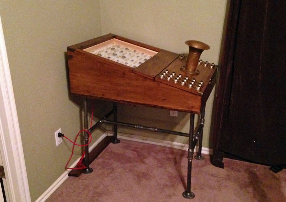

The project is (mostly) finished. I don't know if it's actually "steampunk" but it's definitely steampunk inspired and I'd like to share it with you now. I apologize for the quality of the images. I took them with my iPhone. I hope to have a photo shoot some day at an industrial area or vintage ornate house setting.

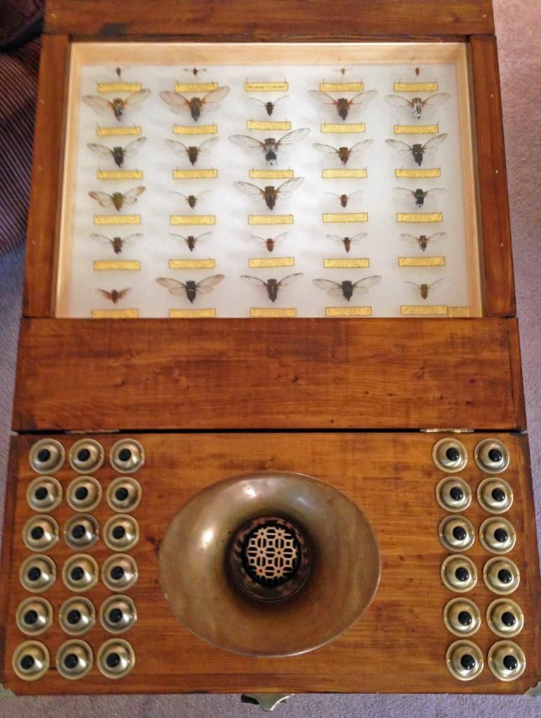

The big brass speaker thingy is a "Klaxon" automobile horn from 1910 or 1911.

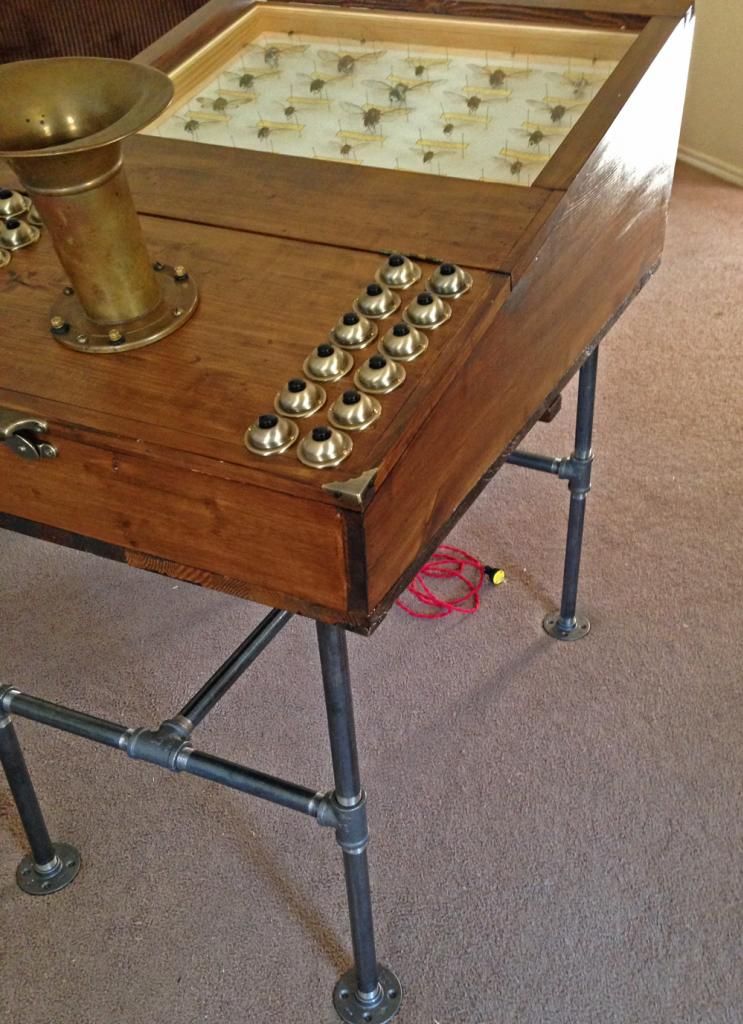

The buttons are brass doorbells. There are 30 of them. The buttons aren't labeled but each button plays a sound that corresponds with the cicada in the case above. There are 30 cicadas (six high and five wide). The buttons are laid out the same way but separated by a speaker. If you want to hear the second cicada from the right on the fourth row up from the bottom, go up and over that many buttons.
The silver ornate screen seen through the horn opening is a speaker grill/cover from a 1955 Nash.

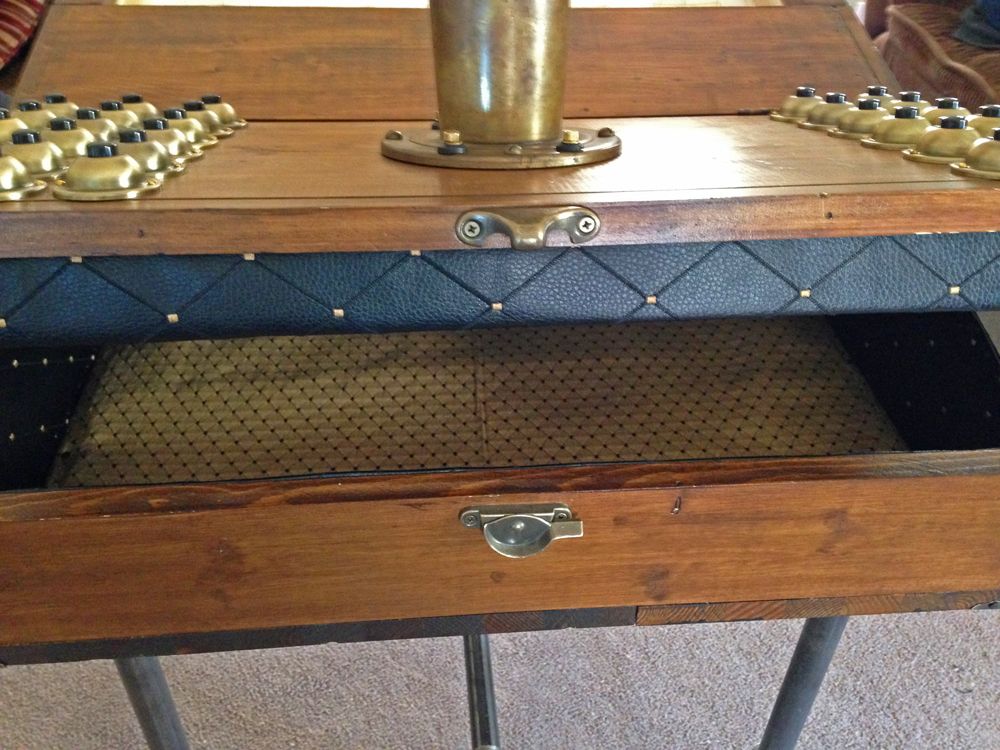

The front portion opens up and is held closed by a brass window sash latch.
The covering over the button wires/speaker and lining the insides of the box are a black fake leather with a diamond pattern and brass-colored stitching at the intersecting lines.
The bottom of the enclosed box portion is padded and covered using a soft fabric that is a smaller reversed sort of design to the sides and lid underside.
The wood is stained pine.

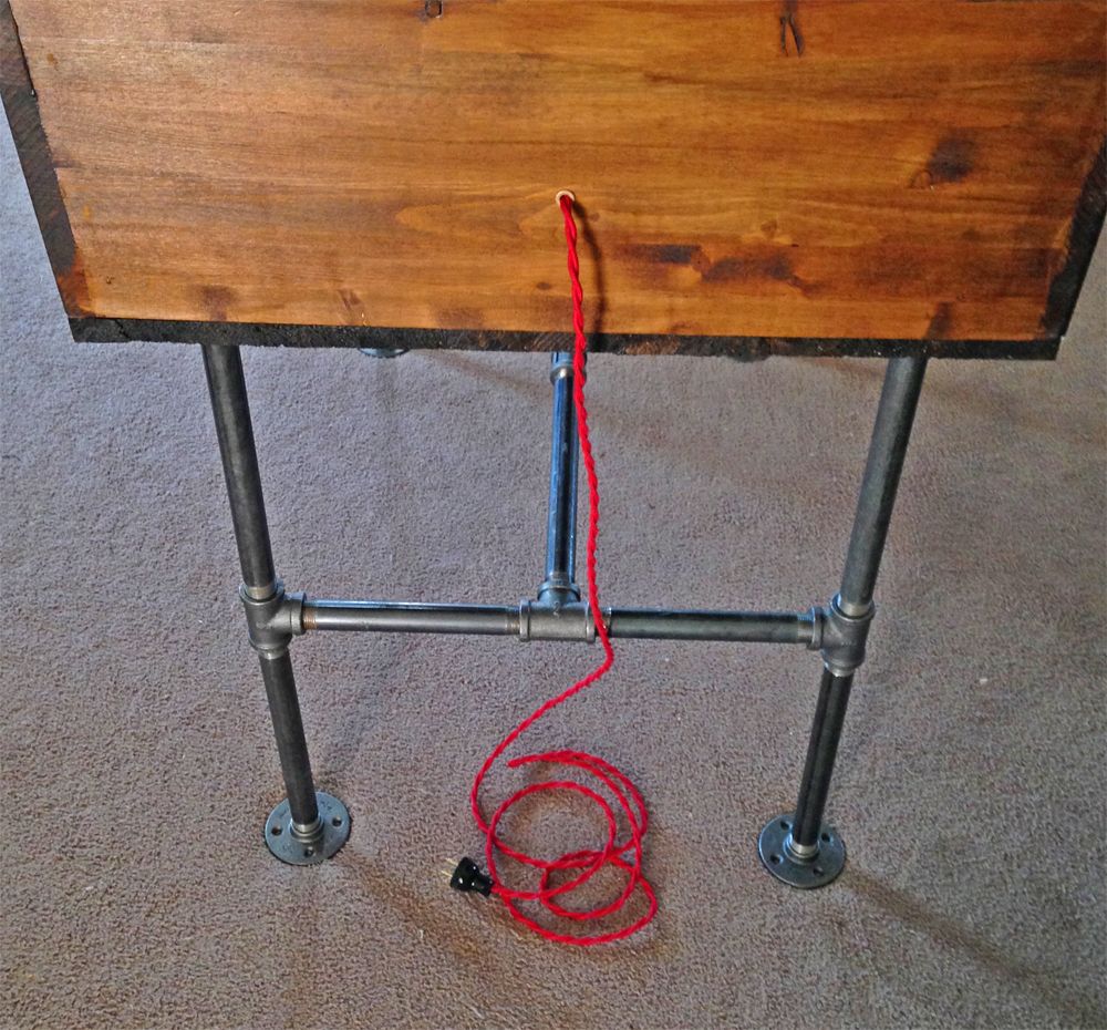

The base/legs are black iron plumbing pipe.
The power cord is antique reproduction cloth-wrapped and twisted red lamp cord. Inside the box power is converted from 120v to 12v before going into the sound board.
The electronic sound board is a Multi-channel sound board MP3 industry player from Waytronic Electronics in China.
The MP3 sounds are mostly from Dave and Kathy at insectsingers.com. I also extracted sounds from videos I took.
The speakers are made by Seiki for multiple laptops.
The display case is air tight and precise from Bio Quip. It measures 18x24x2.5" with a glass face and Plastazote foam.
The labels are on acid free paper made to look aged.
The font is representative of the 1930s.
The cicadas were all collected by myself in Oklahoma. There are five new state records (Two from 2013 and three from 2014). There are ten species known to be in the state that are not represented in this display.
It's mostly finished. I still have a few things I want to add.
