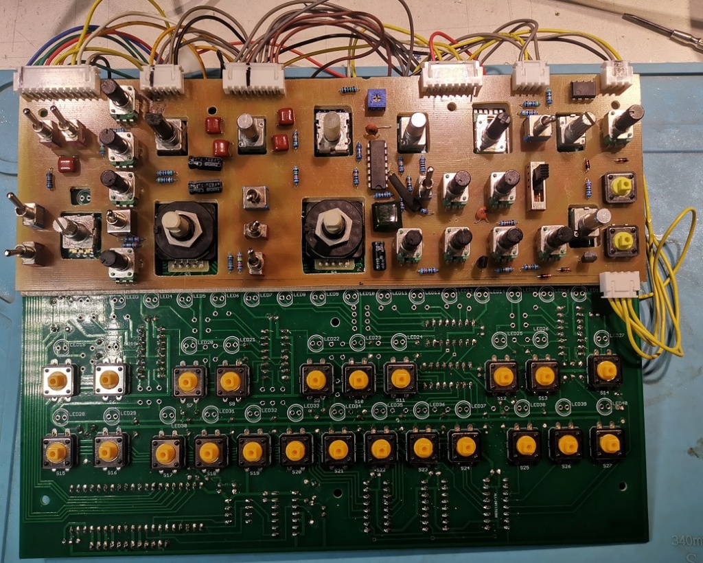

That's it, after quite some time this "little" evolution of the X0xb0x inspired by Brian BANNED's X0xio and other mods found on the Adafruit forum and elsewhere is finally functional in "V1" version.

Here are some pictures of the current versions with prototype version and near final version. Since these versions I have modified the original X0x PCBs to facilitate the installation of mods, without having to install them. On the PCB side of mods, some modifications were also made during the assembly of these versions in order to facilitate installation / connections between PCBs.

The photos of the factory PCBs manufactured by JLCPCB comprising the main X0xb0x and I/Oboard PCBs with modifications to facilitate the installation of mods, the two mod PCBs and small PCBs to supplement the 2SC1583 and 2SC2291 which have become almost impossible to find or out of use price. These PCBs allow two possibilities: to use NPN paired transistor boxes CMS PMP4201Y or to use NPN transistors paired manually with the refs found in the X0x such as the 2SC1815, the 2SC945 or the 2SC536.
After receiving these, I made a few minor modifications to some (writing, pad placement) and I coupled the paired CMS and NPN options on a single PCB.
Modified original X0xb0x PCB and I/Oboard.
The main PCB has additional SMD footprints for the PTC resistors and the 25LC320 EEPROM, pads/markings to facilitate connections with mods...
The PCB I/O board has additional pads to facilitate mod connections, a possibility to place an on/off switch...
First mod PCB
Second mod PCB
PCB NPN paired to replace 2SC153 and 2SC2291
